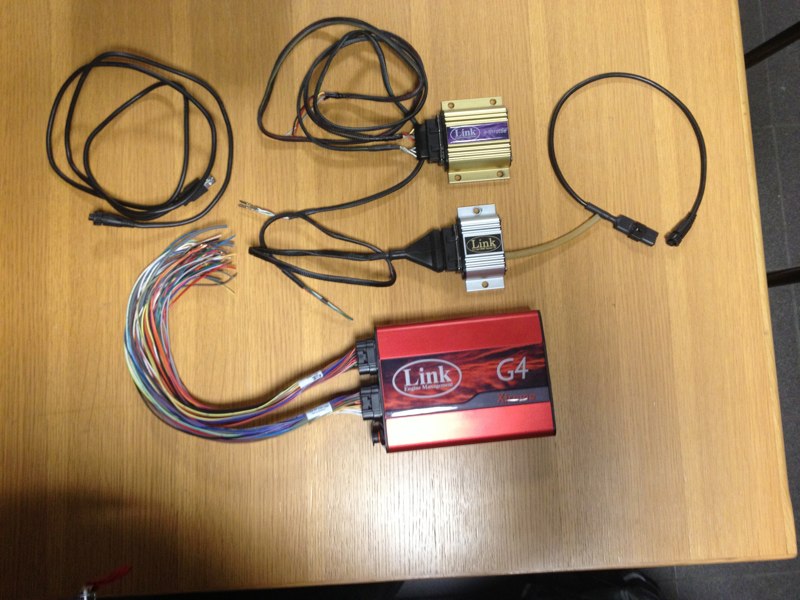

Autronic is getting old. Not much has happened in the last 4 years or so. This after a guy called Ray Hall, who used to be an Autronic distributor but did most of the Autronic support, decided to drop support and start a new ECU brand.
For this to happen he started working together with Link. Instead of becoming a Link distributer a rebranded Link ECU was offered under the name Vi-Pec. There's the Vi-Pec V44,
which is basically the same as the Link G4 Storm and only capable of running 4 cylinder sequential and there's the I5 capable V88,
which is basically the same as the first revision of the Link G4 Xtreme, the silver anodized case version.
The Vi-Pec V88 (Link G4 Xtreme V1) is capable of running electronic throttle out of the box. The later Link G4 Xtreme, red anodized case version,
had the electronic throttle logic removed while the Vi-Pec V88 remained as it was. The Link can now only do electronic throttle using an optional throttle module sacrificing two I/O outputs.
Mr. Ray Hall was responsible for a huge transformation of the tuning software used with both the Link and the Vi-Pec ECU's. With the transformation some of Autronic's best features were also implemented in the software.
